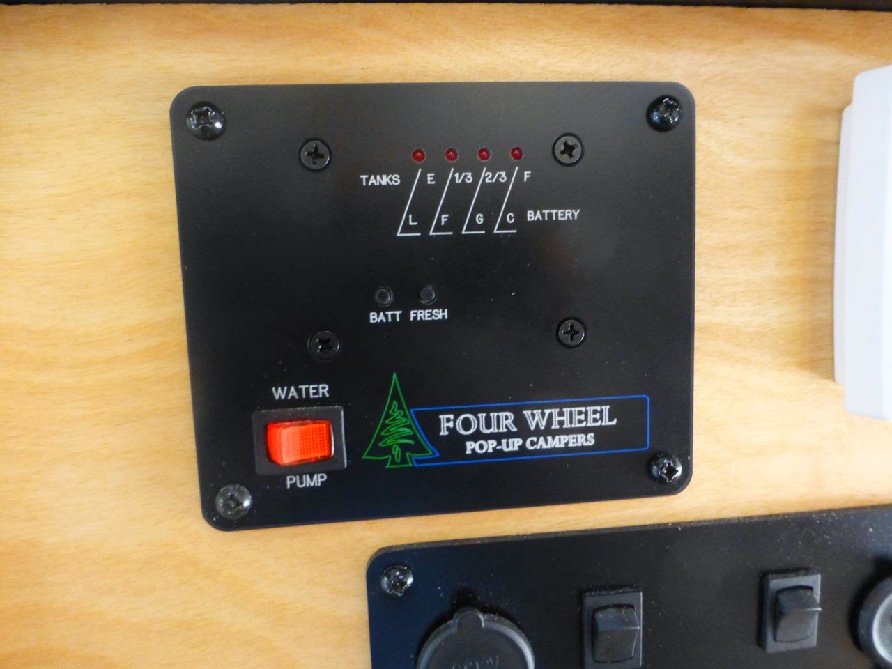

Between TP and Dr appointments have not spend enough time on the camper. I am getting things buttoned up. have everything wired up 12v and 110v with GFI.
FWC monitor panel
Monitor showing battery full.

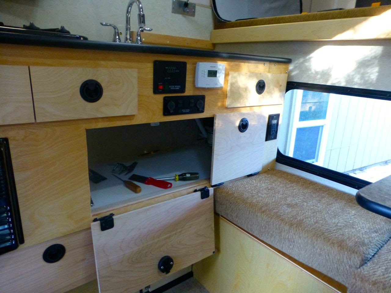

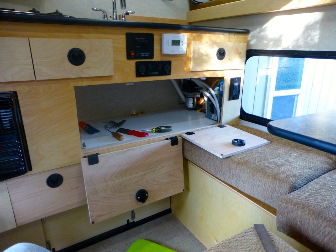

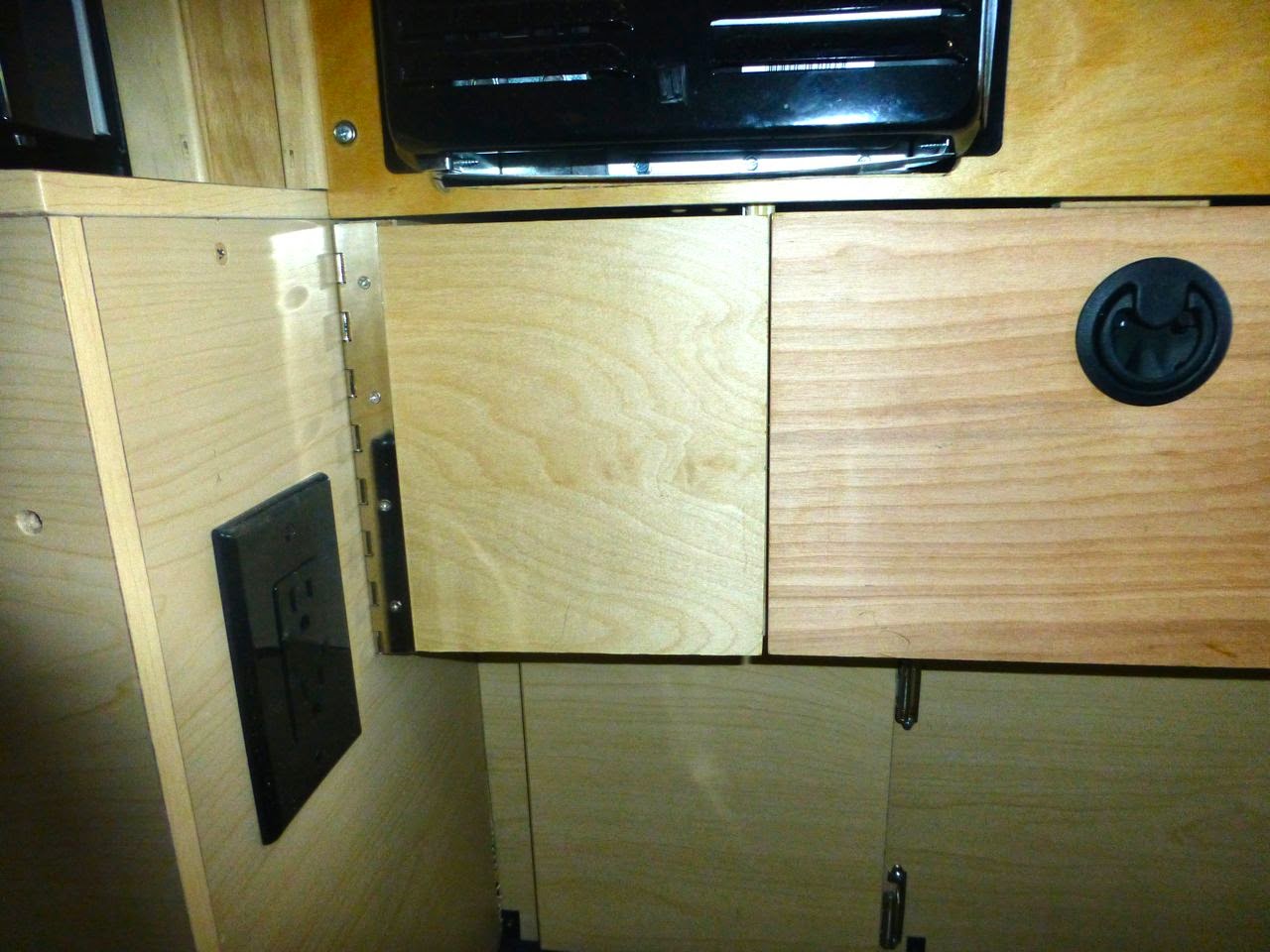

Put door up as one panel and then marked where I
wanted the cut. Helped to keep it square and match grain.
After the cut, large door folds all the way down.
Smaller door lays on seat. 30" wide opening.

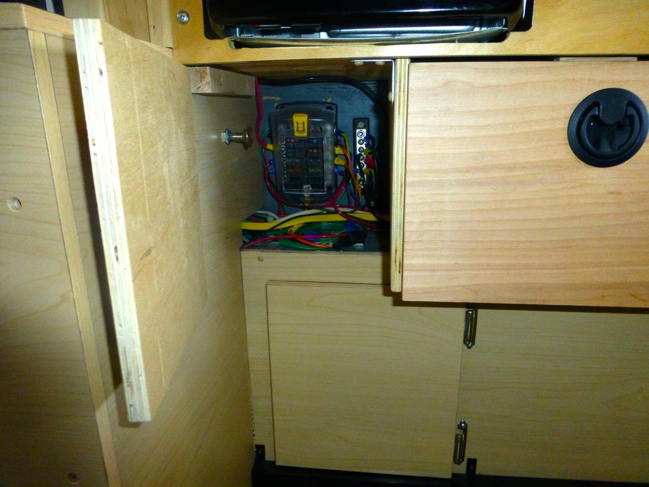

Last door for the day, What does it hide?
Blue sea fuse box behind the door.
Not sure if I want to use magnetic latch, or
a matching slam latch.

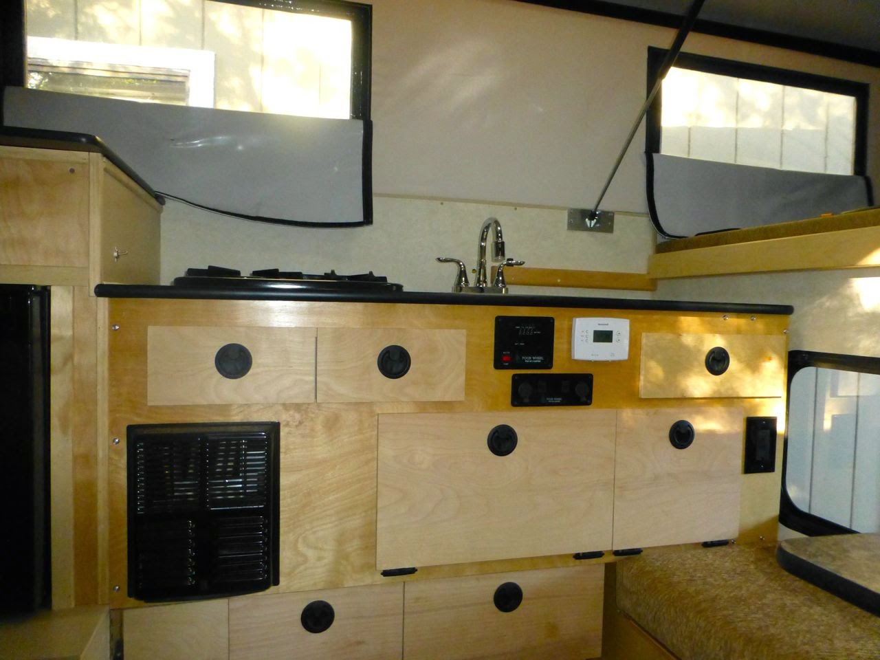

Starting to look like a camper. note trim around the fridge.
I like how the cabinet has come out. Note the drawer fronts, trim and doors still need to have
poly-urethane put on. Just received the white birch iron on trim tape. Tomorrow I will put tape on edges of the drawers and doors. Put on the poly and then start on the corner cabinet next to the dinette.
You will see there are 7 surface screws where I could not get inside to put in screws. Camp-able now just need finish work. Hoping for a shake down trip to Pinnacles NP on the 31st.

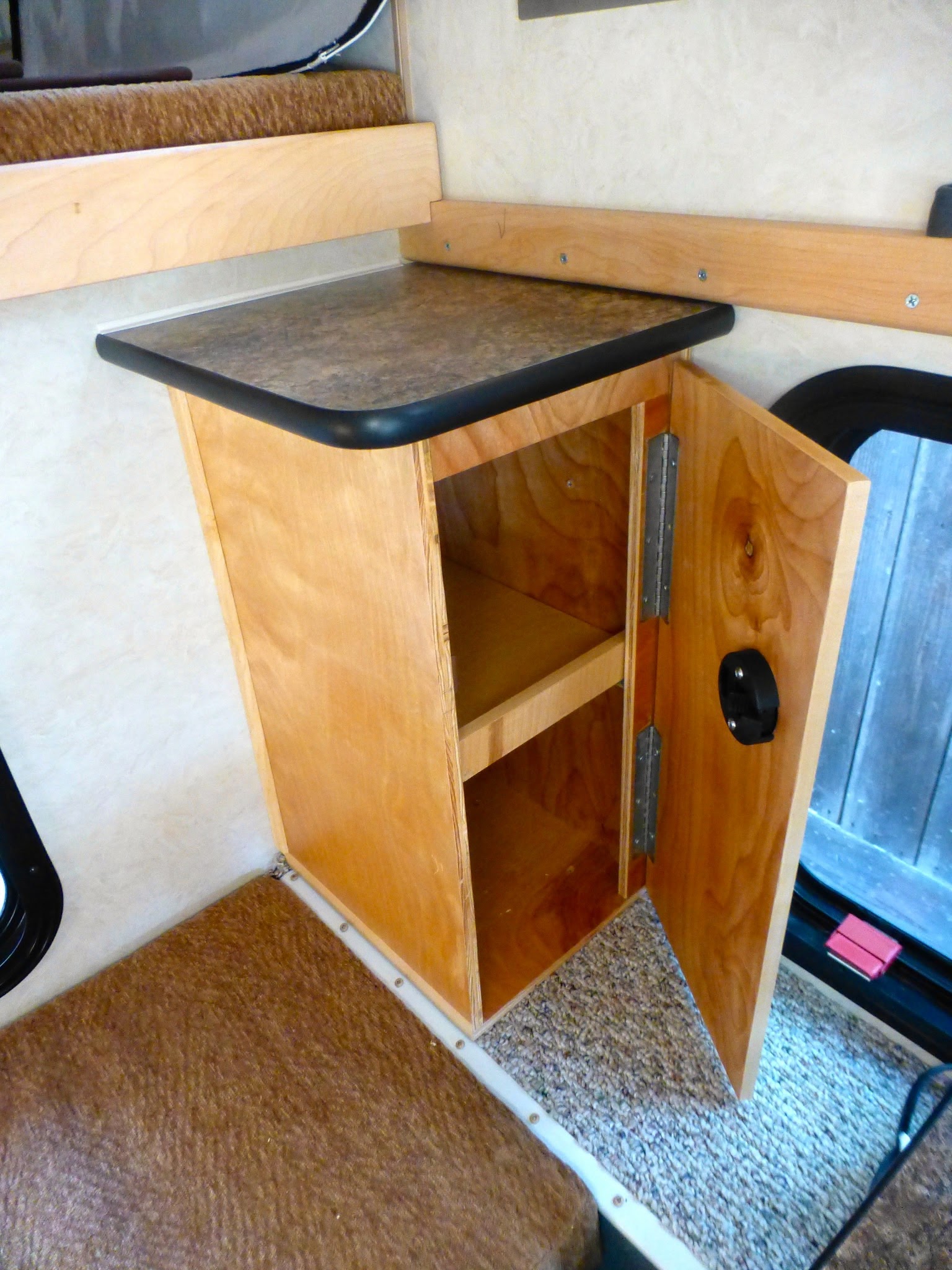

Built and installed the corner cabinet. Looked around and it was time to unload the tools from the camper. Fells good to have the camper ready to load and go camping. But wait Veronica says we have to have curtains. I guess we are not quite ready to camp. Veronica and the neighbor got the curtains made today so tomorrow I put them up and then we are ready to camp.

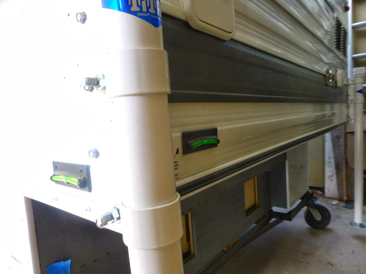

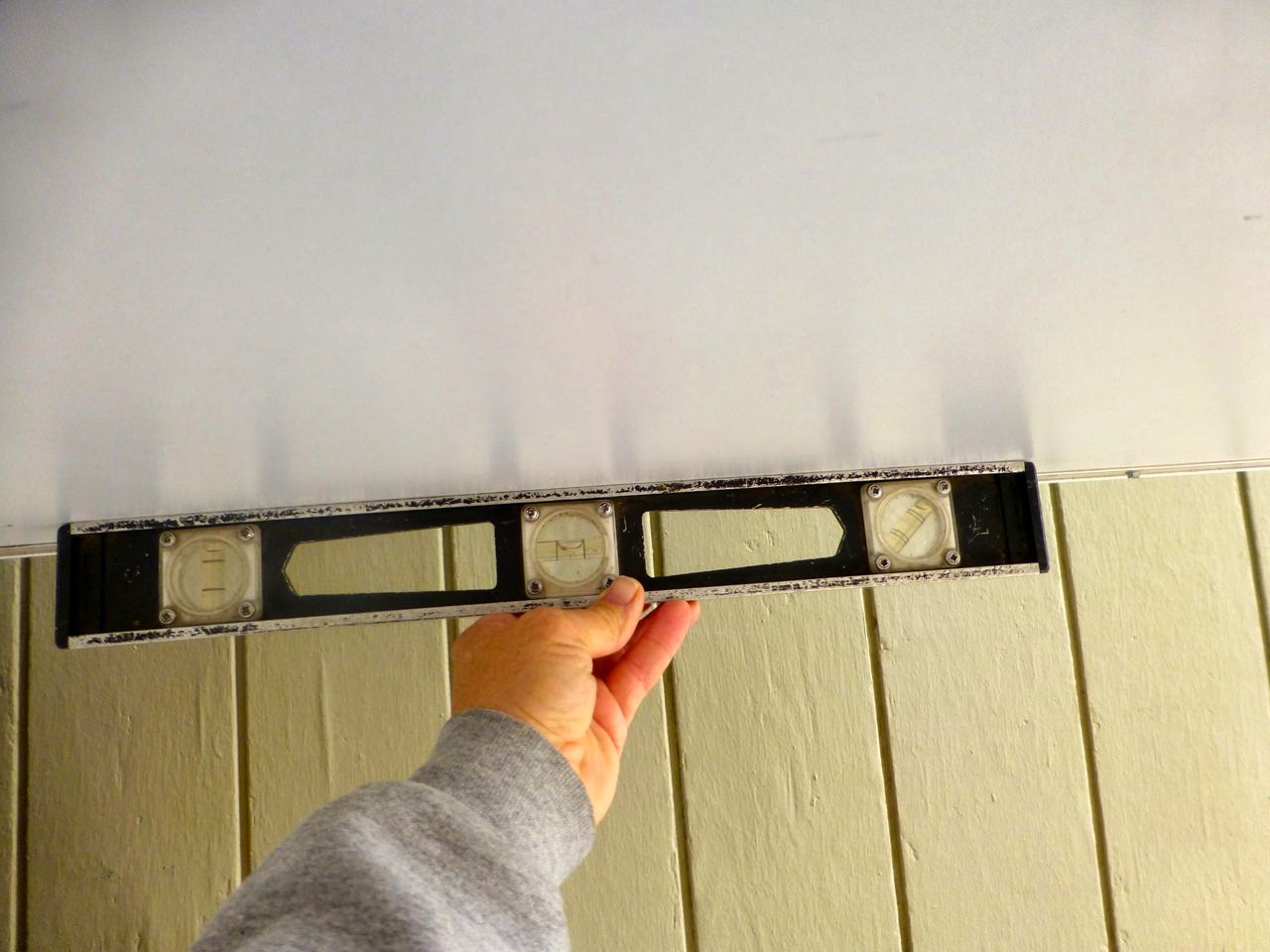

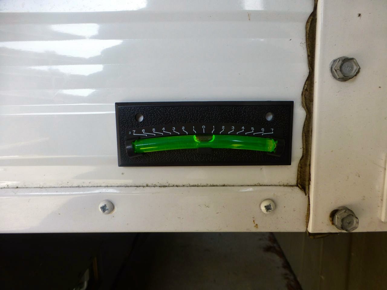

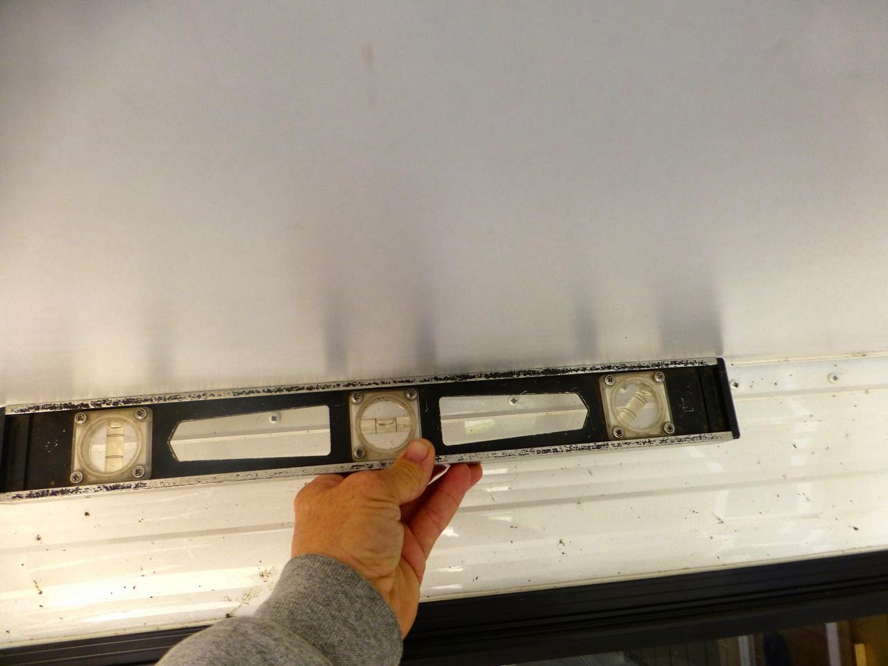

Small things. While the curtains are being finished I worked on two of the small things that needed to be done. Moved the front eye bolts on the pickup bed back 12 inches. The new Hawk has a different location for the tie downs than the old 2002 Hawk. Next I mounted levels on the front and side of the camper. Last time I leveled to the propane fridge, this time I leveled to the front bed.
Level side to side.
Level front to back.
Front level I can see from the cab.
Front and side levels.
Small thing but the levels make it easy to set up camp. Forecast looks like rain next week, so I might build one more cabinet inside be for our shake down trip.
I have those same levels- right outside the driver's door. I've learned from experience how many of the yellow plastic wheel blocks it takes to center the bubbles. Definitely makes leveling the truck easy. The color in the tube disappears after a bit if exposed to the sun. The one under the cabover is still green, the one on the side is now clear.

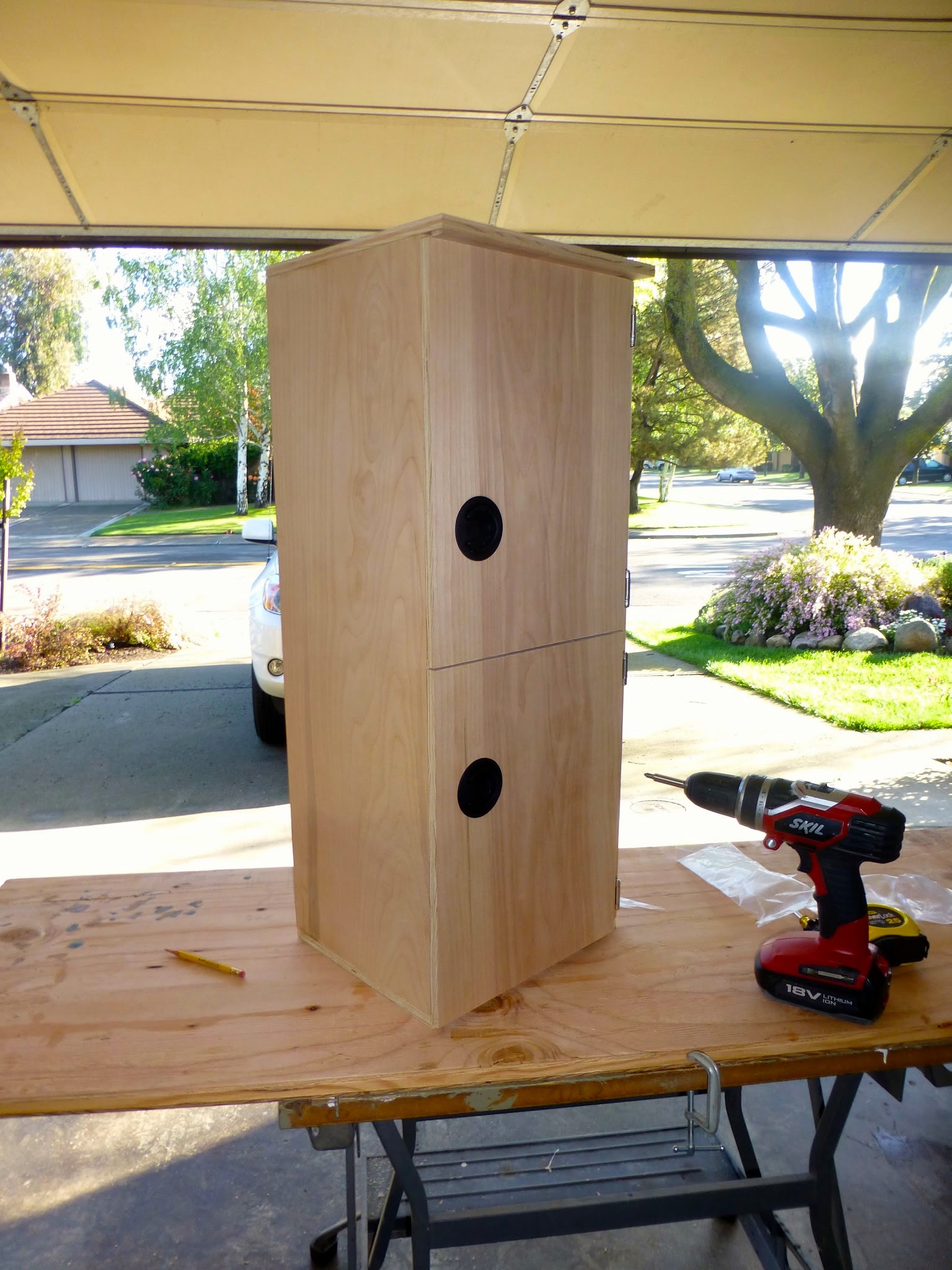

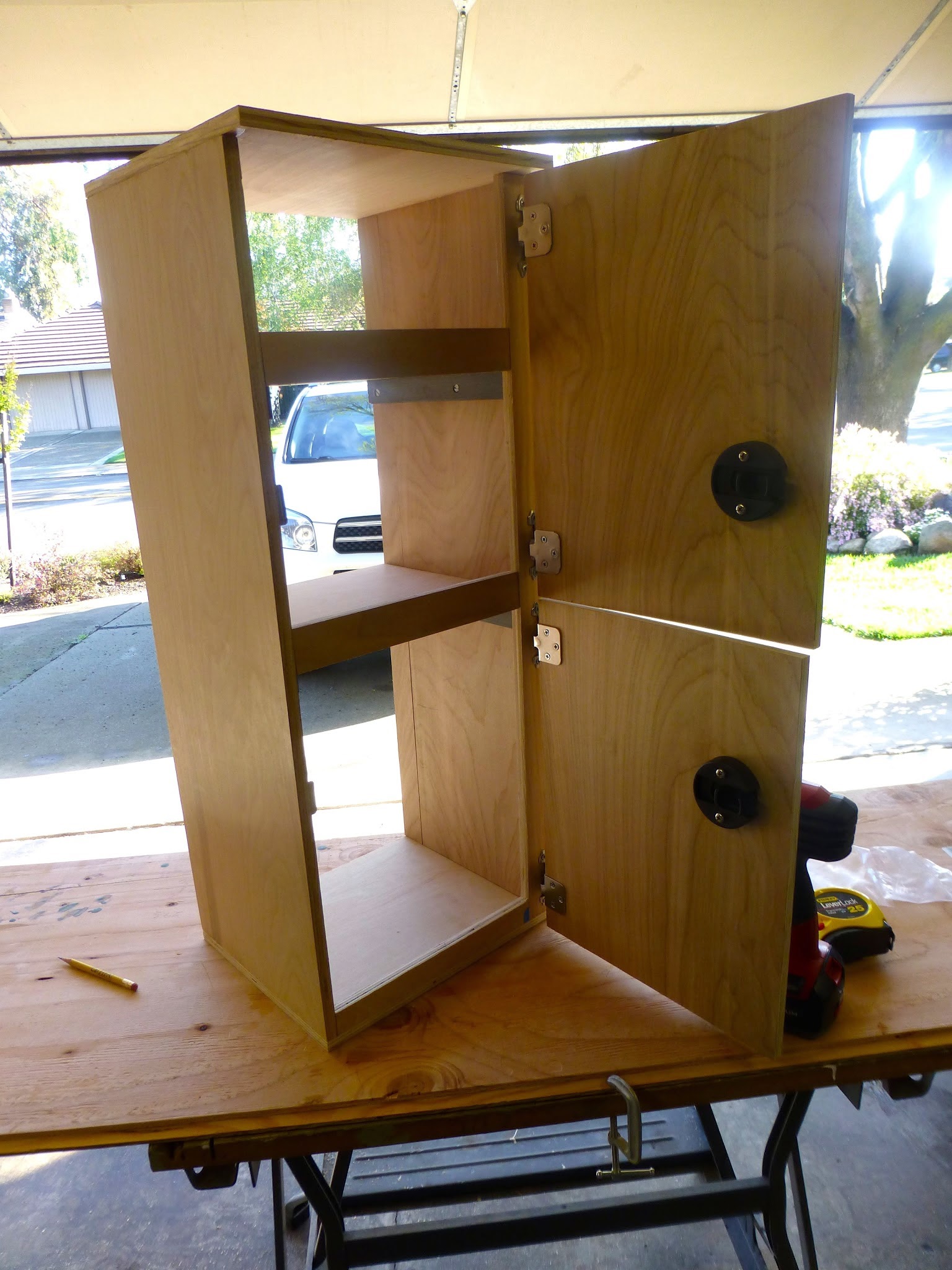

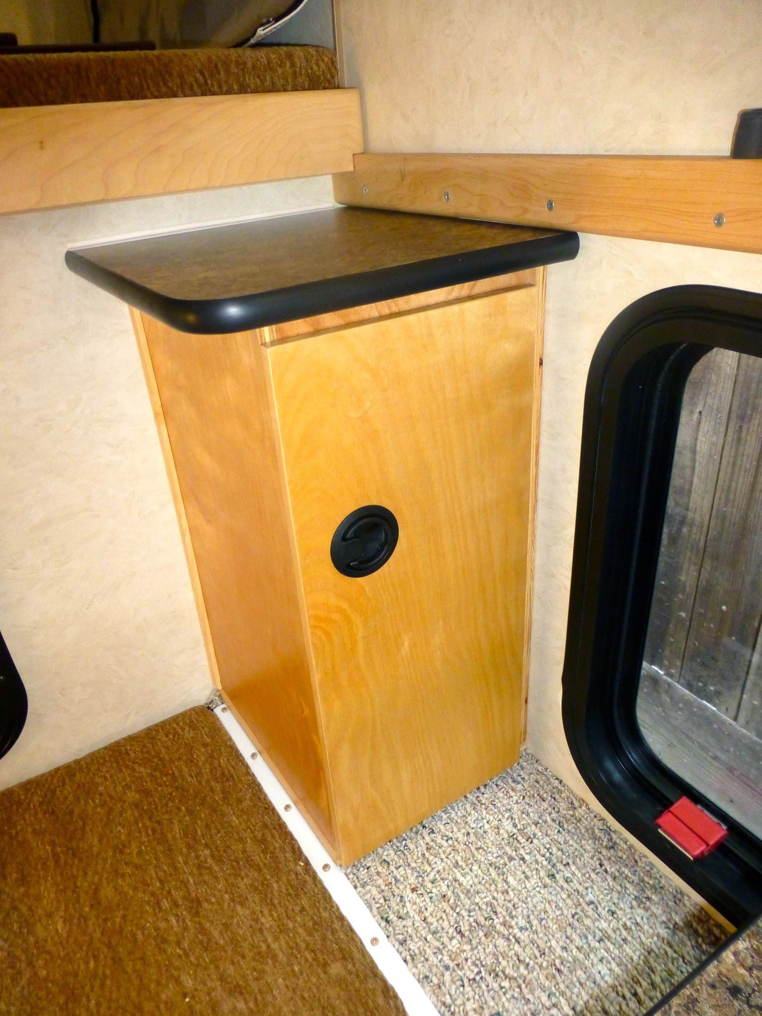

Build last cabinet for rear corner yesterday. Took a quick picture before it comes apart for trim tape and poly urethane. Watching poly dry now so I posted the pictures up. Install tomorrow.
Trim tape? I don't even know what that is. I'll make sure to hide the cabinet I built so no one sees it during the rally tour.
I call it trim tape it is wood veneer with hot melt glue on the back. Great stuff, hot iron, roll tight and magic.
Makes this
Looks like this

Bill - I put the levels inside the cab of the truck so that I can see them while I move the truck to find the best place in the campsite. Works quite nicely.

Got the back cabinet installed. Had to move the FWC overhead cabinet forward to make room in the back corner. I like how it came out. Put two doors on the cabinet. Top door opens and has two shelfs, lower shelf in the top is sized to fit my coffee pot. Bottom door opens to one large space so tall items, like a roll of paper towels or big bottles will fit. I bought an extra 2'x4' birch plywood so the grain on the doors would match.
Passenger side of the camper in picture below. Showing dinette, new front cabinet, new rear cabinet and FWC cabinet moved forward. If the bed is pulled back I use the FWC cabinet as a stand to hold my radio.
Top door open on new back cabinet.
Bottom door open, wire is for blue sea 12v plug on order.
