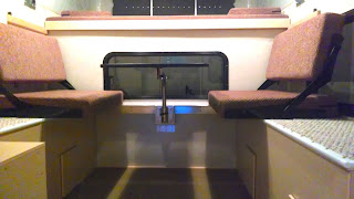

There is some precedent for a downward opening door. It is hard to see in this pic, but the lowest door does open down. With my wife being 5'0" I've pondered making it more robust so that she can use it as an elevated standing platform.
